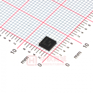

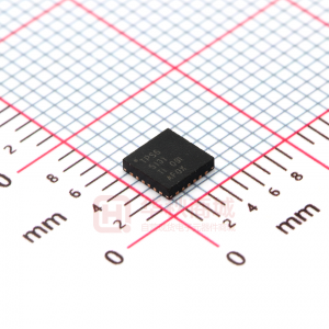

型号:TPS65131RGER 封装:VQFN24_4X4MM_EP
品牌:TI 描述:NO-40℃~+85℃@(TA)2可调±15V 2.7V ~5.5V VQFN24_4X4MM_EP DC-DC转换器ROHS
