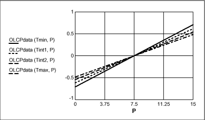

Sensor Signal Data Offset, Gain and Nonlinearity Correction
The sensor signal characteristics are also dependent on temperature and the excitation source (pressure). The objective here is to eliminate the temperature dependency and linearize the pressure response characteristics.Just as the case of the temperature signal, we will maximize the response to 90% of the total useful range, yielding -0.9 for minimum pressure, and +0.9 for the maximum pressure.
The raw sensor data is depicted below, for four different temperatures
Figure 9. Raw sensor data x pressure (psi).
The linear coefficients for these curves, using the endpoint values, can be given by:
Figure 10. Sensor sensitivity x Temperature (°C). The pressure nonlinearity and offset correction function can be expressed by:
Figure 11. Sensor Offset and nonlinearity x Pressure (psi)
The objective now is to model the reciprocal of the pnl(T, P) function for four different temperatures, and then model the variation of the coefficients over temperature.

The variation of those coefficients over the temperature data can be modeled by third order equations, solving a linear system:![]()
The correction coefficients are:![]()
And the zero, first, second and third order coefficient functions are given by:![]()
The offset and nonlinearity correction function is then given by:![]()
And the final offset and nonlinearity corrected sensor data is now given by:![]()
Figure 12. Offset and nonlinearity corrected sensor data x pressure (psi).

At this point, the sensor data is normalized to -0.9 to +0.9 for the minimum and maximum sensor excitation. All the nonlinearities have been corrected and the temperature dependency is removed. It is a very linear signal with respect to the excitation (pressure).
