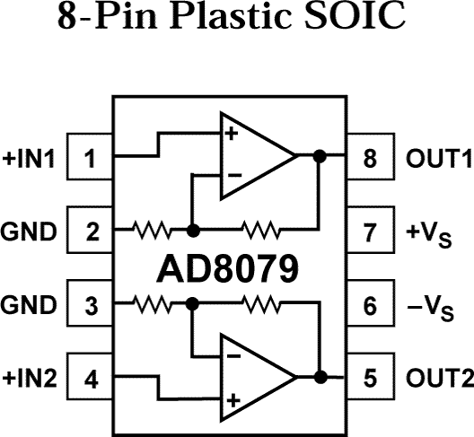

The AD8079 is a dual, low power, high speed buffer designed to operate on ±5 V supplies. The AD8079's pinout offers excellent input and output isolation compared to the traditional dual amplifier pin configuration. With two ac ground pins separating both the inputs and outputs, the AD8079 achieves very low crosstalk of less than -70 dB at 5 MHz.
Additionally, the AD8079 contains gain setting resistors factory set at G = +2.0 (A grade) or Gain = +2.2 (B grade) allowing circuit configurations with minimal external components. The B grade gain of +2.2 compensates for gain loss through a system by providing a single-point trim. Using active laser trimming of these resistors, the AD8079 guarantees tight control of gain and channel-channel gain matching. With its performance and figuration, the AD8079 is well suited for driving differential cables and transformers. Its low distortion and fast settling are ideal for buffering high speed dual or differential A-to-D converters.
