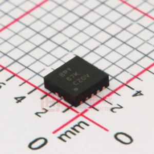

型号:TPS63000DRCR 封装:VSON10_3X3MM_EP
品牌:TI 描述:1 降压升压可调1.2V~5.5V 1.8V~5.5V 1.6A 1.5MHz VSON10_3X3MM_EP DC-DC转换器ROHS
