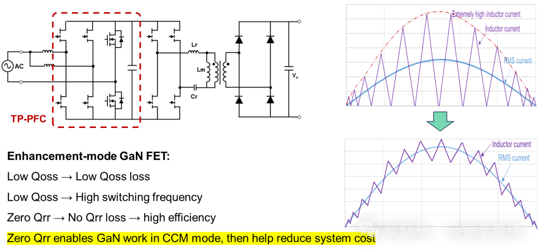

Zero Qrr enables GaN to work in CCM TP-PFC?

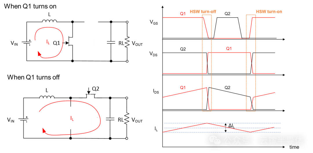

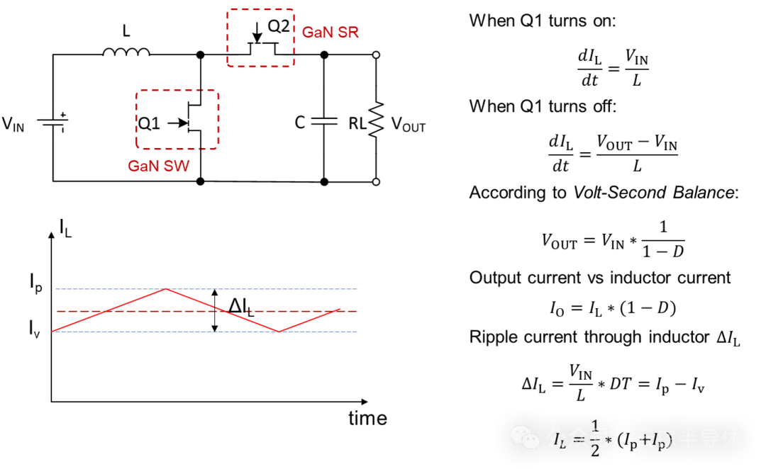

In each half cycle of the AC input, the TP-PFC can be analyzed as a synchronous boost converter.
02
Synchronous CCM boost converter – waveforms

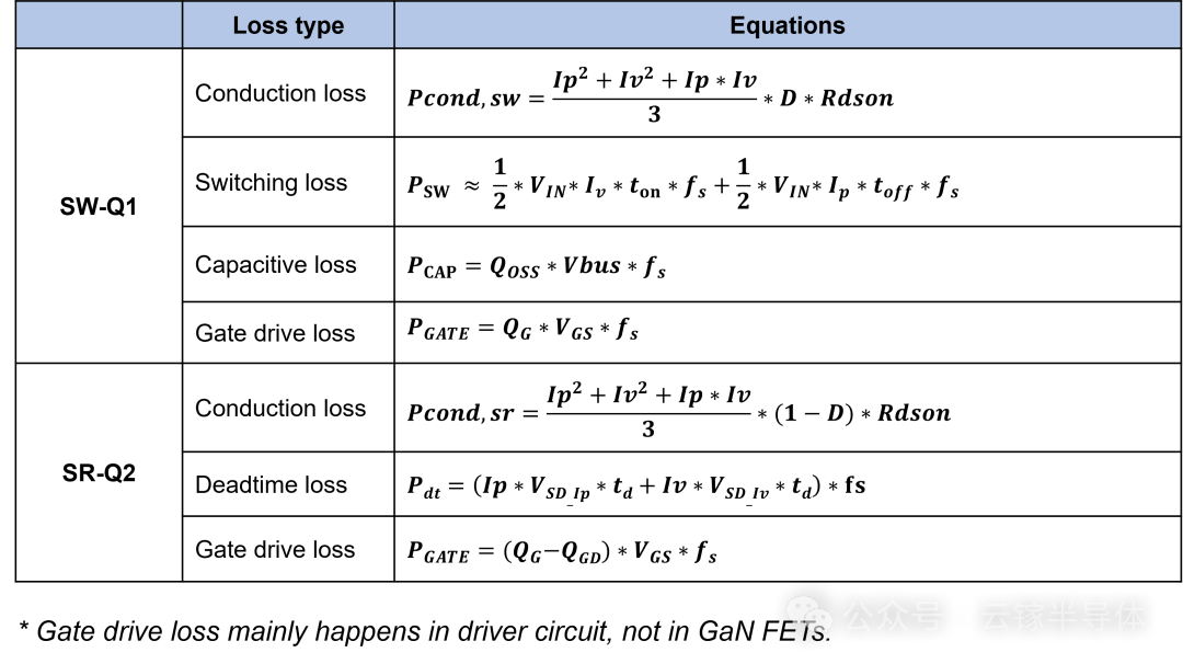

Loss breakdown of a boost
02

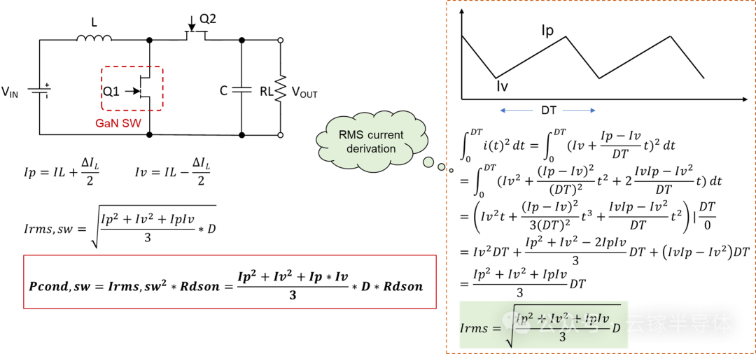

Loss breakdown of GaN FETs: SW conduction loss
03

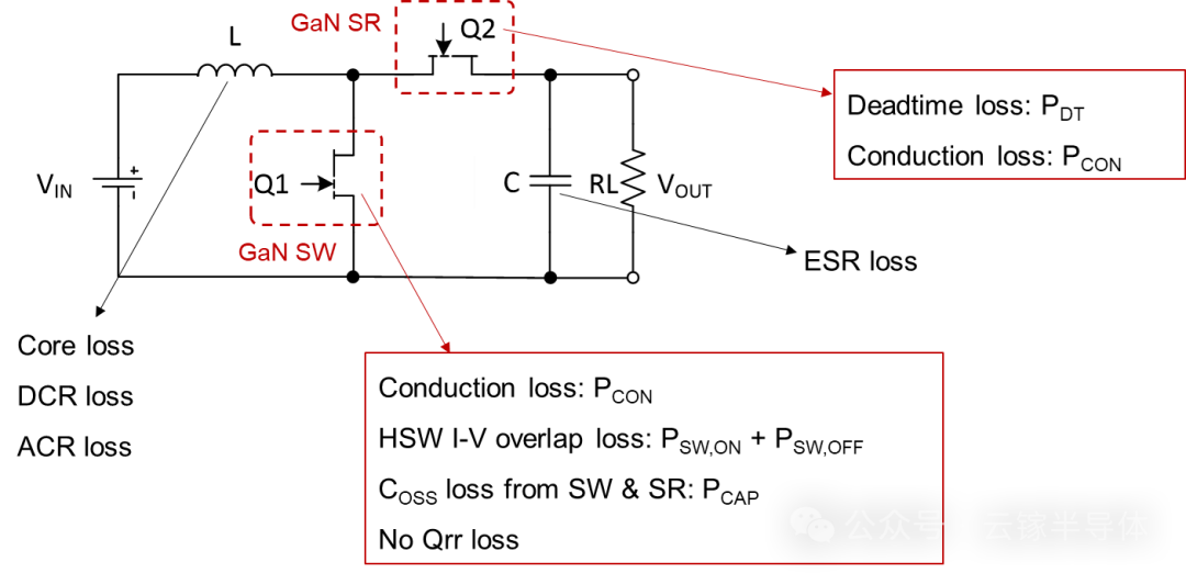

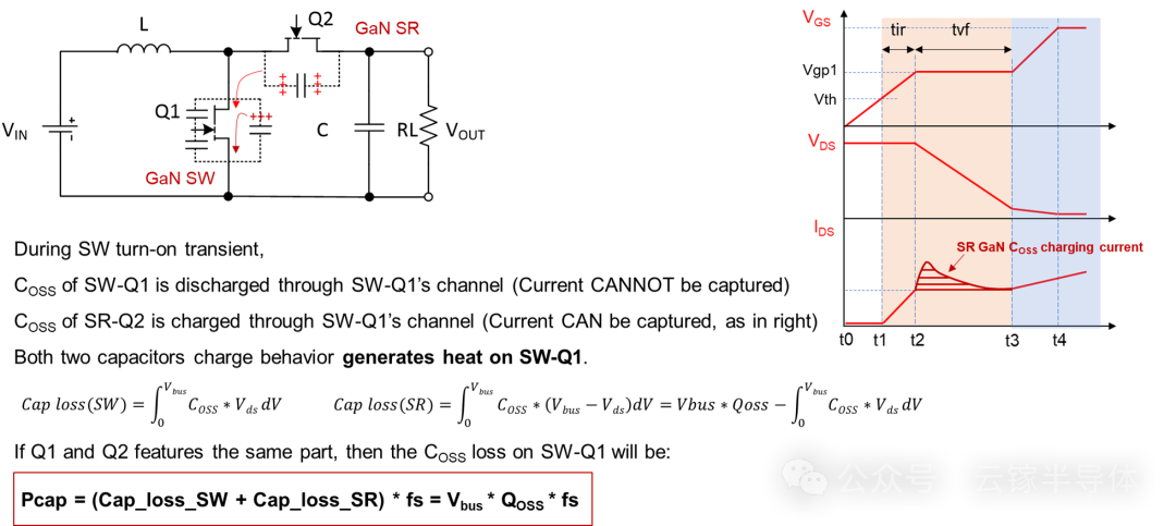

Loss breakdown of GaN FETs: SW+SR Coss loss

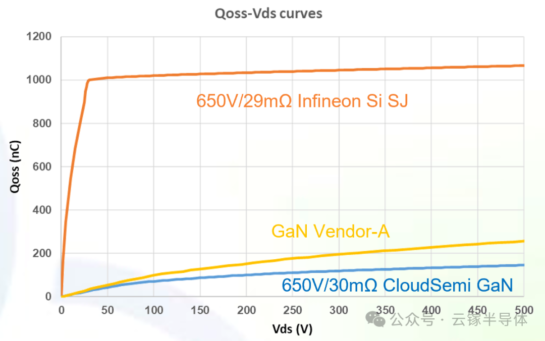

CloudSemi GaN has a superior Qosscomparing to other GaN vendors.
04

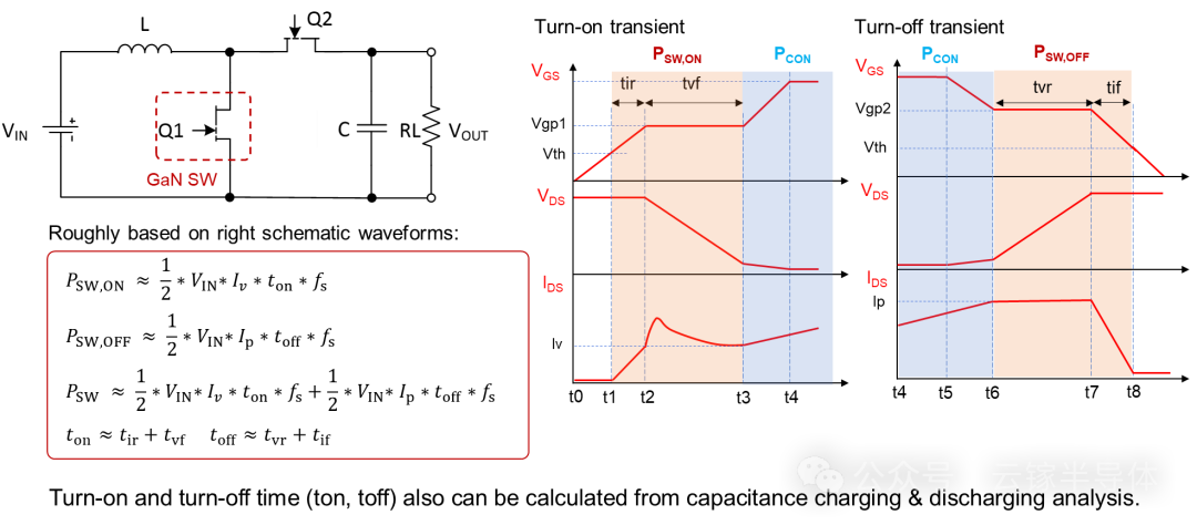

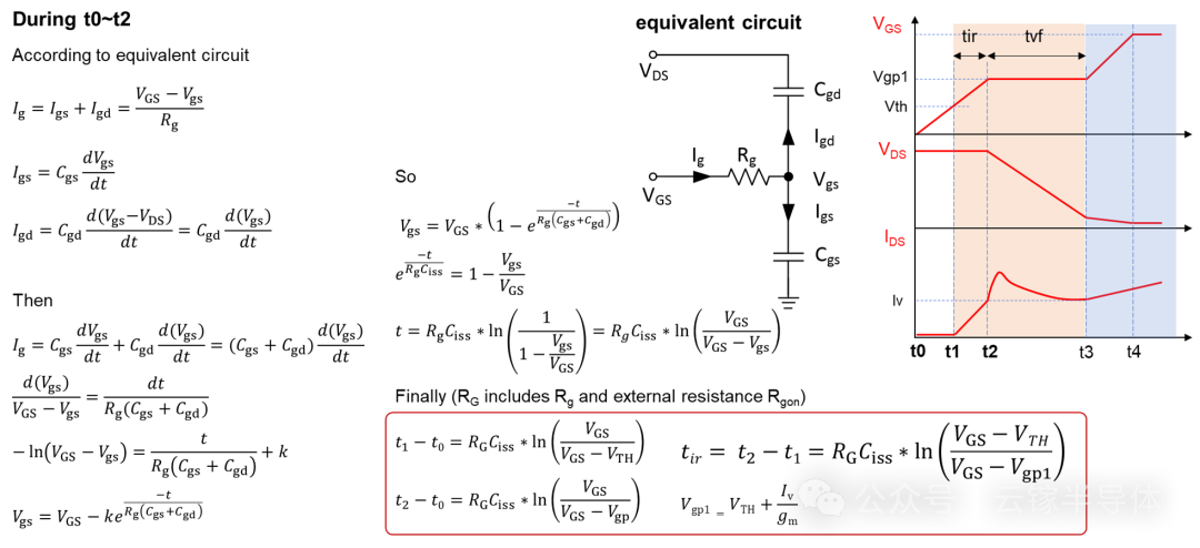

Loss breakdown of GaN FETs: SW I-V overlap loss
05

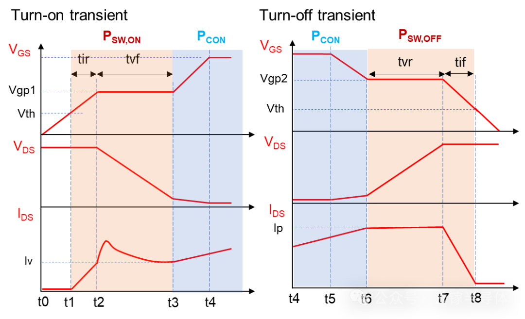

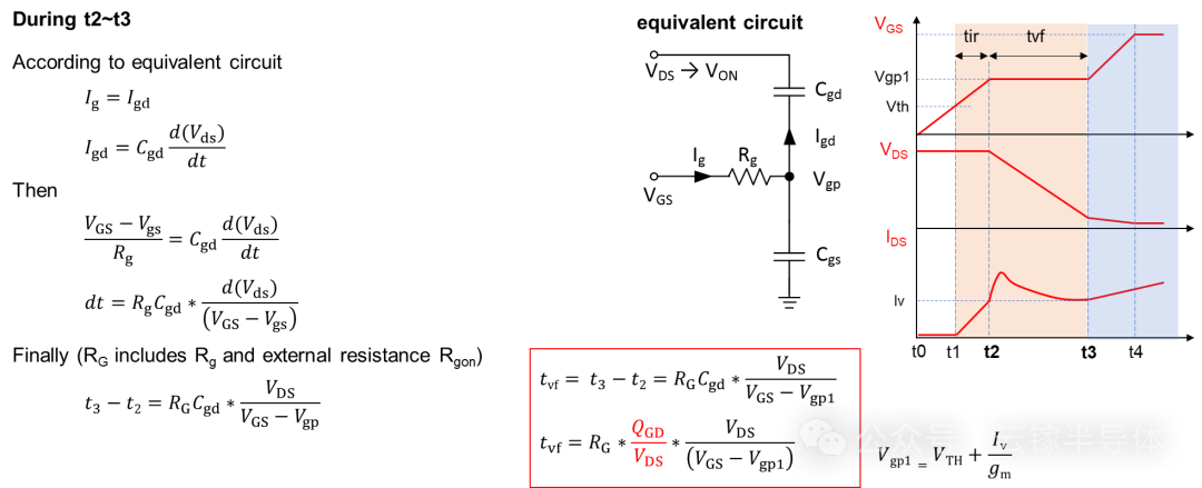

Switching time - tir
06
Switching time - tvf
07

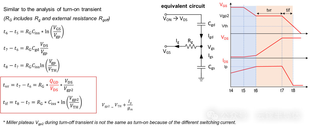

Switching time – tvr & tif

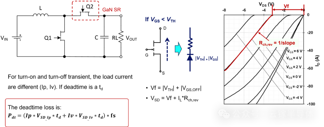

08

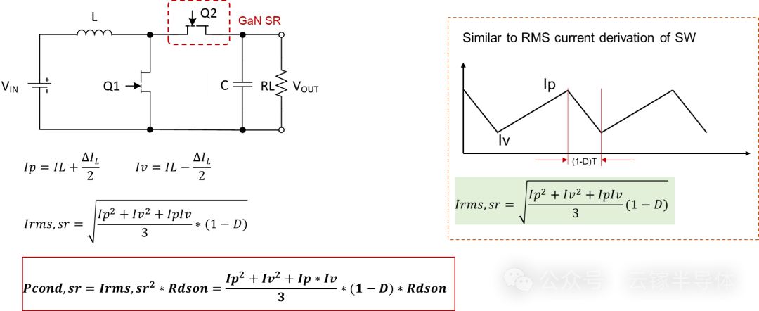

Loss breakdown of GaN FETs: SR conduction loss
09
Loss breakdown of GaN FETs: SR deadtime loss
Part 3 : Summary
01
Summary
