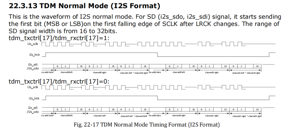

传统 I2S 的 LRCLK 仅切换左右声道,而 TDM 模式下:
1.LRCLK 升级为帧同步信号,一个周期内按顺序传输 8 个声道的完整数据;
2.BCLK(位时钟)频率翻倍,计算公式:BCLK频率=采样率×声道数×采样位深;
3.仅用 1 根 SDIN/SDOUT 数据线,串行传输所有声道数据,大幅简化硬件布线。

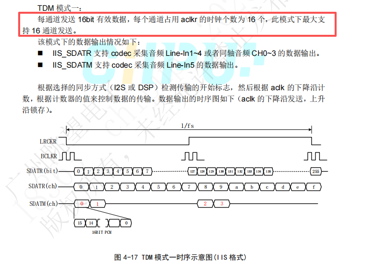

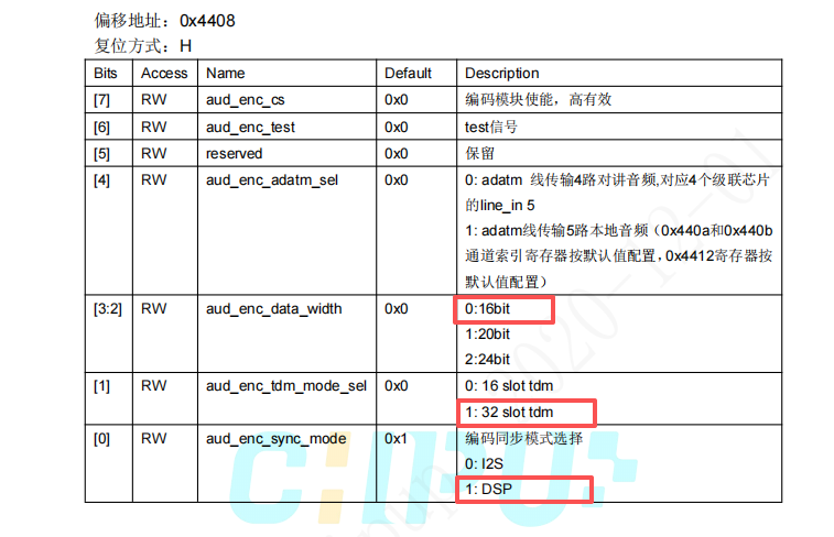

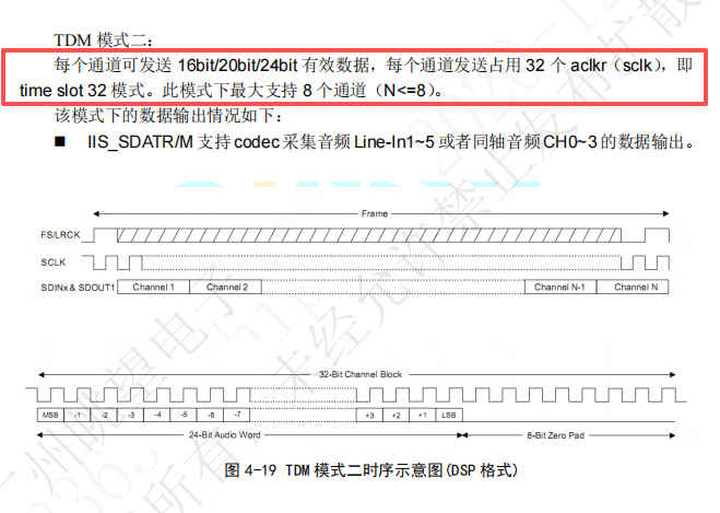

XS9922B 是专为高清音视频采集设计的芯片,支持两种核心配置:
• 配置 1:slot-num为16,slot-width为32(适合 16 声道,RK3588 不支持);
• 配置 2:slot-num为8,slot-width为32(与 RK3588 匹配)。
核心优势:AHD 视频 + TDM 音频同步采集,单芯片搞定多路音视频输入,大幅降低硬件成本和开发难度。

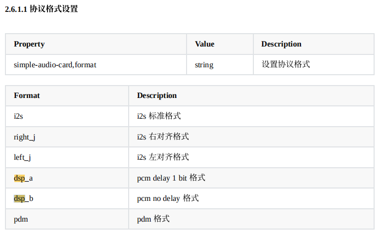

// I2S08通道TDM配置&i2s0_8ch { status ="okay"; pinctrl-names ="default","idle","clk"; pinctrl-0= <&i2s0_sdi0 &i2s0_sdo0>; pinctrl-1= <&i2s0_idle>; pinctrl-2= <&i2s0_lrck &i2s0_sclk>; rockchip,always-on; //保持时钟常亮 rockchip,tdm-fsync-half-frame;//TDM帧同步模式 rockchip,capture-channels = <8>;//配置8个采集声道};//I2C3挂载XS9922B Codec&i2c3{ status ="okay"; xs9922: xs9922@30{ status ="okay"; #sound-dai-cells = <0>; compatible ="xs9922"; reg = <0x30>; clocks = <&mclkout_i2s0>; clock-names ="mclk"; assigned-clocks = <&cru I2S0_8CH_MCLKOUT>; reset-gpios = <&extio EXTIO_GPIO_P00 GPIO_ACTIVE_HIGH>; power-gpios = <&extio EXTIO_GPIO_P01 GPIO_ACTIVE_HIGH>; assigned-clock-rates = <11289597>;//匹配44.1kHz采样率时钟 pinctrl-names ="default"; pinctrl-0= <&i2s0_mclk>; };};//声卡配置:关联CPU与Codec,TDM参数匹配xs9922_sound: xs9922-sound { compatible ="simple-audio-card"; simple-audio-card,name ="rockchip,tdm-8ch"; simple-audio-card,format="dsp_a";//匹配XS9922B的DSP-A格式 simple-audio-card,mclk-fs = <256>; simple-audio-card,bitclock-master = <&codec_master>; simple-audio-card,frame-master = <&codec_master>; status ="okay"; simple-audio-card,cpu { sound-dai = <&i2s0_8ch>; dai-tdm-slot-num = <8>; //8个时隙 dai-tdm-slot-width = <32>;//32bit位宽 }; codec_master: simple-audio-card,codec { sound-dai = <&xs9922>; };};

RK3588 内核中 I2S 驱动(kernel/sound/soc/rockchip/rockchip_i2s.c),其中 rockchip_i2s_set_fmt 负责配置协议格式,默认已原生支持 DSP-A/B 格式,与 XS9922B 完全兼容,无需修改驱动代码:
•DSP-A:PCM 延迟 1bit 模式(本次采用);
•DSP-B:PCM 无延迟模式。
staticintrockchip_i2s_set_fmt(structsnd_soc_dai *cpu_dai,unsignedintfmt){ mask = I2S_TXCR_IBM_MASK | I2S_TXCR_TFS_MASK | I2S_TXCR_PBM_MASK;switch(fmt & SND_SOC_DAIFMT_FORMAT_MASK) {caseSND_SOC_DAIFMT_RIGHT_J:val = I2S_TXCR_IBM_RSJM;break;caseSND_SOC_DAIFMT_LEFT_J:val = I2S_TXCR_IBM_LSJM;break;caseSND_SOC_DAIFMT_I2S:val = I2S_TXCR_IBM_NORMAL;break;caseSND_SOC_DAIFMT_DSP_A:/* PCM delay 1 bit mode */val = I2S_TXCR_TFS_PCM |I2S_TXCR_PBM_MODE(1);break;caseSND_SOC_DAIFMT_DSP_B:/* PCM no delay mode */val = I2S_TXCR_TFS_PCM;break;default:ret = -EINVAL;gotoerr_pm_put;}}

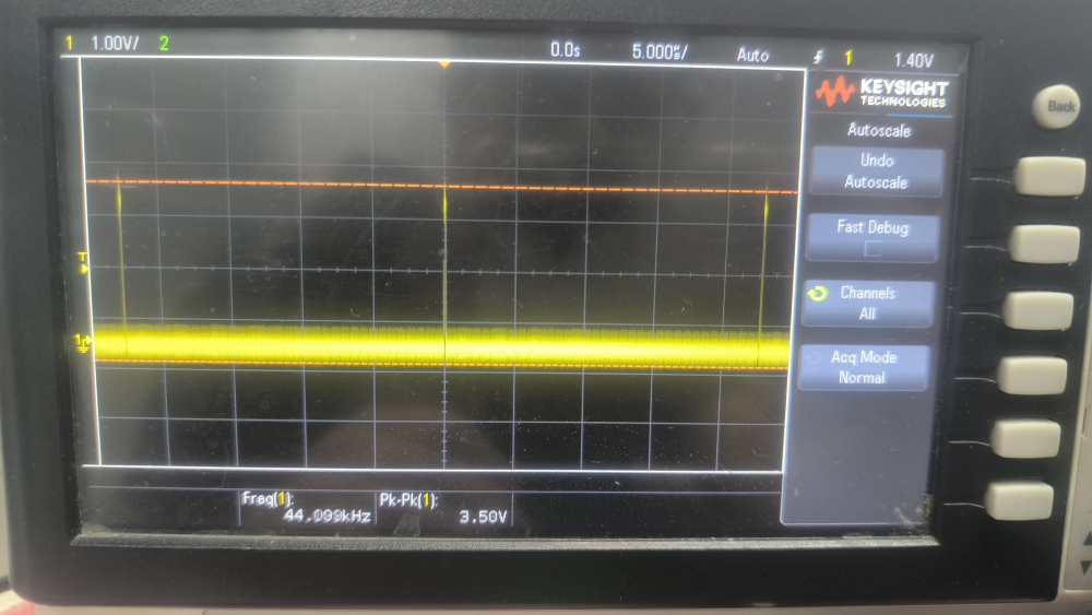

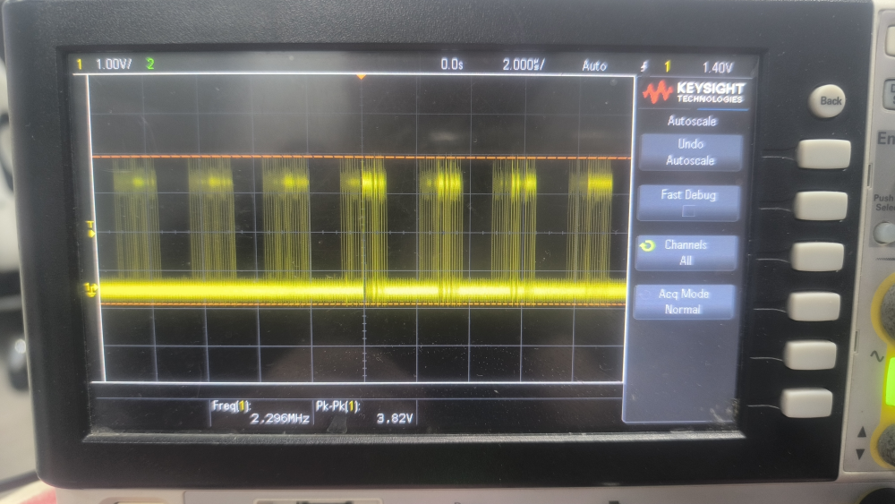

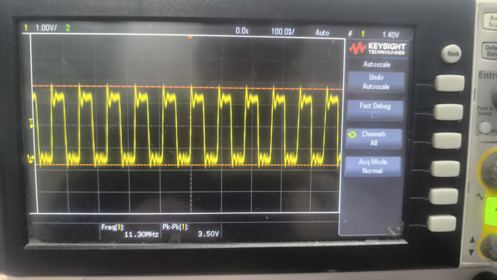

波型实测
•LRCLK:频率 44.1kHz,方波信号稳定;
•BCLK/MCLK:频率 11.2896MHz,脉冲波形清晰;
•SDATA:8 声道音频数据串行输出,波形无失真;
e46863fe-5b11-11f1-ab55-92fbcf53809c.png五、总结
