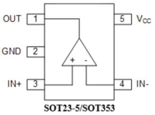

AiP3245:

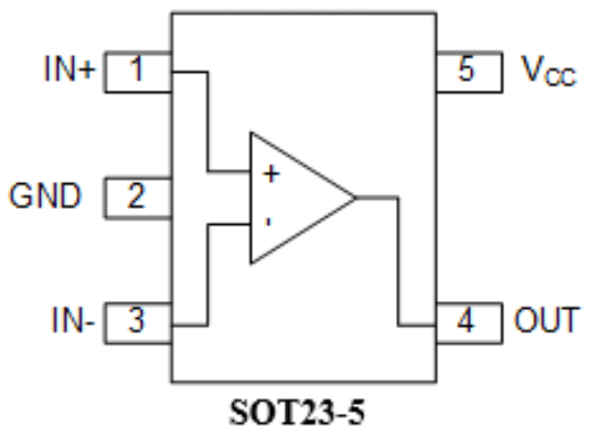

AiP3245B:

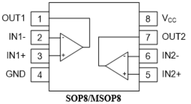

AiP3246:

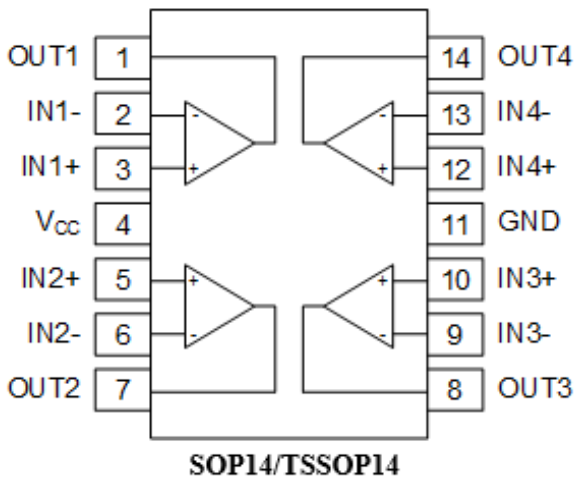

AiP3248:

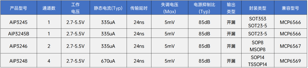

AiP324X详细参数见下表(左右滑动查看更多):
