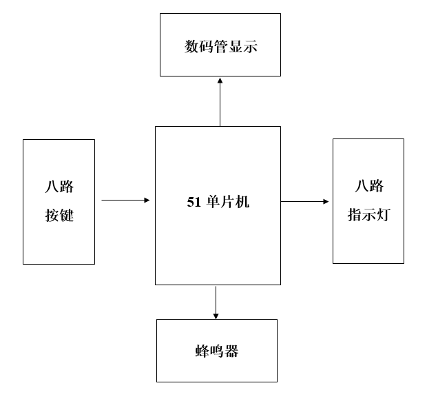

5. 完整原理图模块
|  抢答按钮×8      |----->| P1.0~P1.7    |      |               |
| (接地+上拉电阻)  |      |              |      |   数码管       |
+-----------------+      |   STC89C52   |----->| (P0口驱动)     |
|  复位按钮       |----->| RST/P3.2     |      |               |
| (硬件/软件复位) |      |              |      |  蜂鸣器        |
+-----------------+      |              |----->| (P2.0+8550驱动)|
|  晶振电路       |----->| XTAL1/XTAL2  |
| (11.0592MHz)    |      +--------------+
