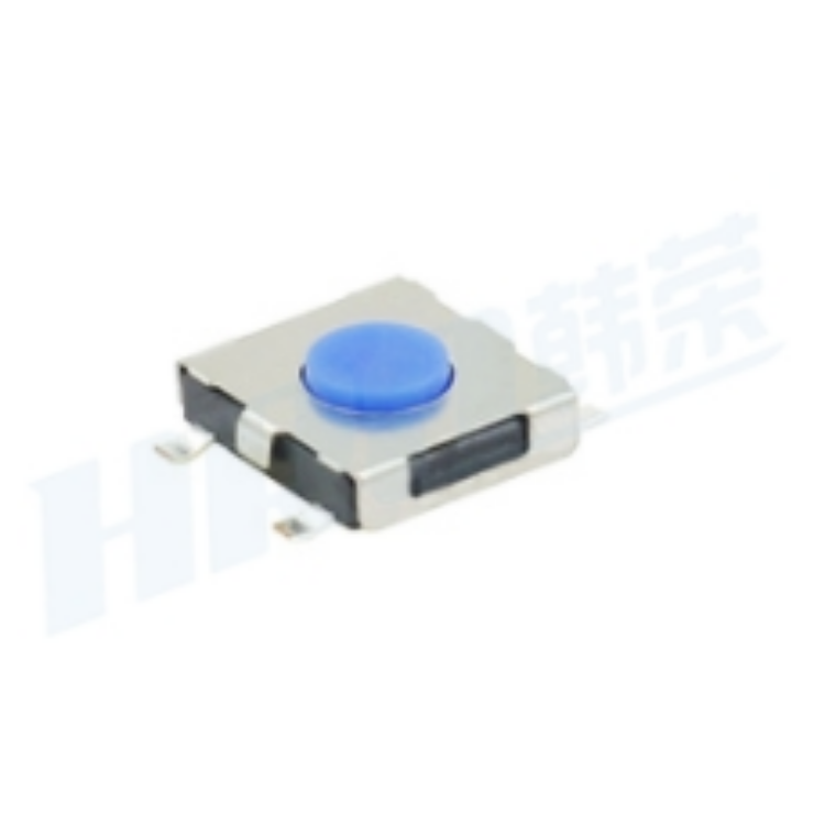

6*6蓝色硅胶按键
2022-05-14 16:52:21

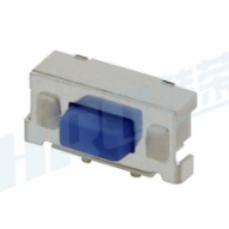

3*6硅胶按键
2022-05-31 10:43:17

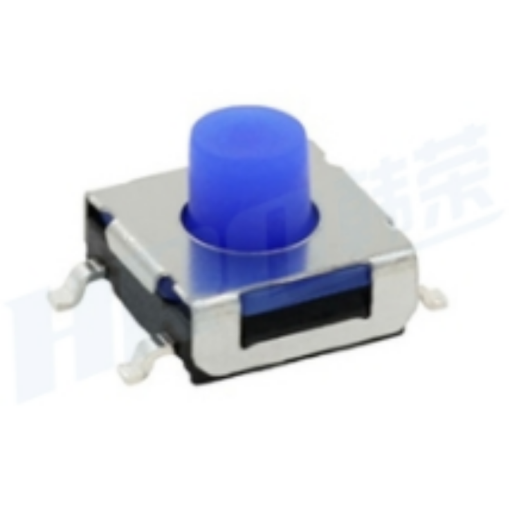

4.5*4.5硅胶按键
2022-05-14 16:55:51
