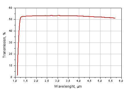

For imaging systems the right choice of material is of utmost very importance. Defects in the material can cause image distortion and violate the system operation. This is the reason why so much attention is paid to selecting the material and its control. To provide the proper quality of material, silicon ingots with special parameters (dislocation-free optical grade monocrystalline Cz-Si with high homogeneity and transparency in the working range) were grown. After a few required ingots with diameter to 219 mm were ready the quality of material (resistance homogeneity, dislocation density, transmittance in the working range) is being controlled on samples prepared from each ingot. The typical transmission curve is presented here.
Si transmission
 Fig. 1 Silicon transmission in the 1.1 - 5.7 mm spectral range. Sample thikness is 10 mm.

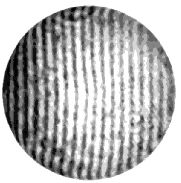

For interferometric control Fizeau scheme is applied, λc = 632.8 nm (HeNe laser line). Additional equipment such as telescopic expanders and measuring objectives is used if required by surface shape and radius of curvature. Evaluation of the form error of a surface is being carried out in phase mode by means of measuring the deformation of the wavefront reflected from the controlled surface compared to test reference surface. Specialised integrated software is used to create phase data arrays and their further power polynomial approximation for surface error calculations.

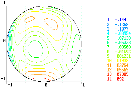

Here we present as examples the results of such control for 2 surfaces: 1 - concave surface of meniscus D210 mm lens, and 2 - plane surface of 198 x 134 mm plate.
Interferometric measurements of errors of meniscus lens D210 mm
  • Controlled surface, mm
  • Test area, mm
  • Measurement units
  • Reference surface
concave R = -206.99
clear aperture - central D206
microns
sphere
Regular errors:
D= .080LX= 2.839LY= -.013C= 2.829RMS(W)= .031
A= .050FIA= .354 RMS(W-A)= .023FA= .442
B0= -.025RZ= .037
 RMS(W-Z)= .029FZ= .131
B2= .149
B4= -.149
C= .110FIC= 164.892 RMS(W-C)= .028FC= .178
Local errors:
R= .139RMS(M)= .015
Parameters of surface:
RMSMINMAXRSTRLSTRH
.031-.144.092.237.964.988
X :-1.000.000
Y :.000-1.000
 Fig. 2 Reconstracted wavefront topography presented at planar and 3-d plots.
 Fig. 3 Interferogram of the surface.

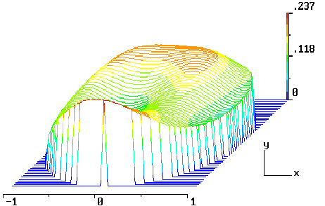

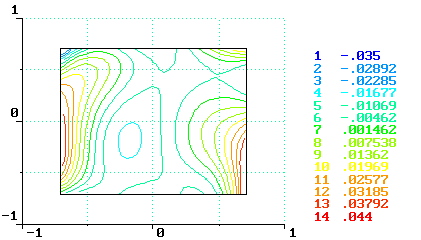

Interferometric measurements of errors of plane parallel plate 198x134 mm
The surface undergoes measurements in 2 areas: center zone of dimensions 70 x 70 mm (approximately the area occupied by incident ray) and the whole aperture 194 x 130 mm.
  • Controlled surface S1
  • A/ Test area, mm
  • Measurement units
  • Reference surface
plane R = infinity
70 x 70
microns
plane
Regular errors:
D= .000LX= 1.447LY= .033C= .964RMS(W)= .014
A= .045FIA= 82.986 RMS(W-A)= .010FA= .489
B0= -.014RZ= .023 RMS(W-Z)= .012FZ= .235
B2= .064
B4= -.045
C= .012FIC= 173.740 RMS(W-C)= .014FC= .009
Local errors:
R= .076RMS(M)= .007
RMSMINMAXRSTRLSTRH
.014-.035.044.079.993.998
X :-.680.680
Y :.680-.680
Reconctracted wavefront topography presented at 3-d plots
 Fig. 4 Reconctracted wavefront topography presented at planar and 3-d plots.

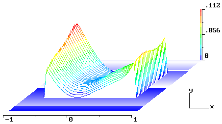

  • B/ Test area, mm
  • Measurement units
  • Reference surface
194 x 130
microns
plane
Regular errors:
D= .000LX= 2.811LY= .053C= 2.045RMS(W)= .024
A= .104FIA= 81.477 RMS(W-A)= .011FA= .787
B0= -.020RZ= .083 RMS(W-Z)= .016FZ= .561
B2=.039
B4= .117
C= .022FIC= 50.186 RMS(W-C)= .023FC= .014
Local errors:
R= .077RMS(M)= .012
RMSMINMAXRSTRLSTRH
.024-.036.076.112.978.993
X :-.200.680
Y :.480-.440
Fig. 5 Reconctracted wavefront topography presented at planar and 3-d plots.
