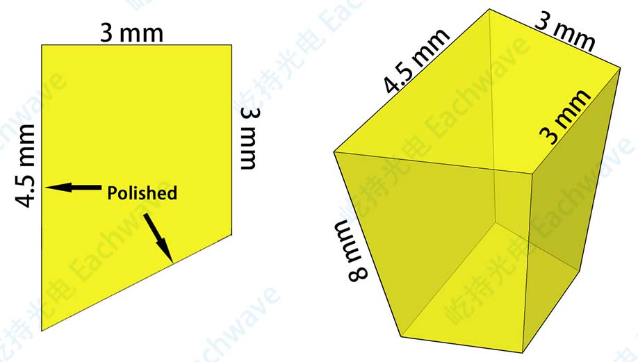

铌酸锂晶体(LiNbO3),太赫兹晶体产品规格:(用于波前倾斜强场太赫兹系统)
型号参数晶体立体图
MgO- LiNbO3-3x3x4.5x8
· MgO:LiNbO3 stoichiometric crystal 0.6%-1%
· Size    3x3x4.5x8 mm
· Wedge angle    63°
· Two side be polished
· Surface λ/4 at 633 nm
· Coating AR at 800nm/1030, R<0.25% on one side
· MgO concentration    0.6%-1%

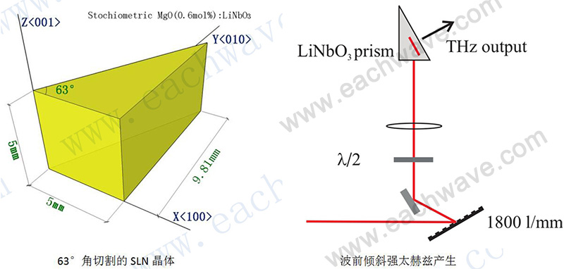

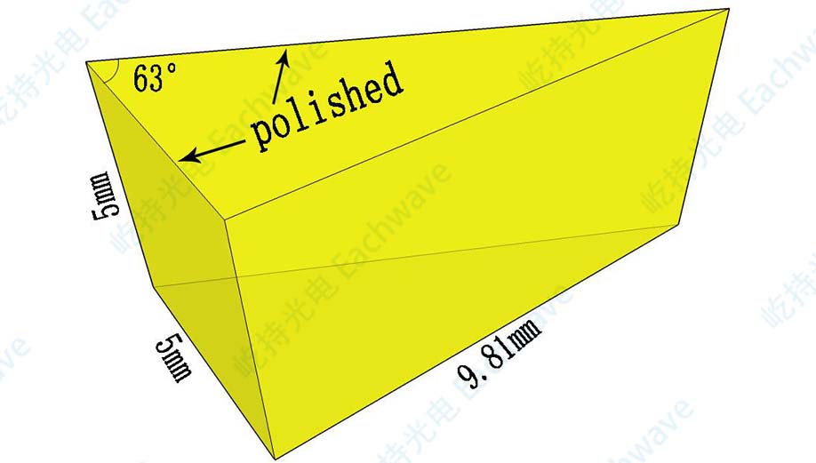

MgO- LiNbO3-5x9.81x5
· Size    5x9.81x5mm
· Wedge angle    63°

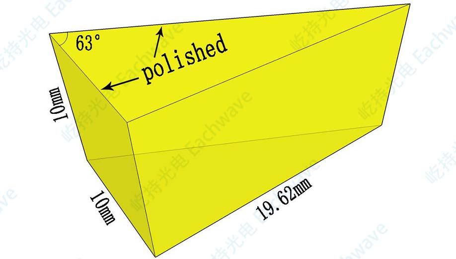

300
MgO- LiNbO3-10x19.62x10· MgO:LiNbO3 stoichiometric crystal 0.6% -1%
· Size    10x19.62x10mm
· Wedge angle    63°
· Coating AR at 700nm-1100nm, R<0.25% on one side

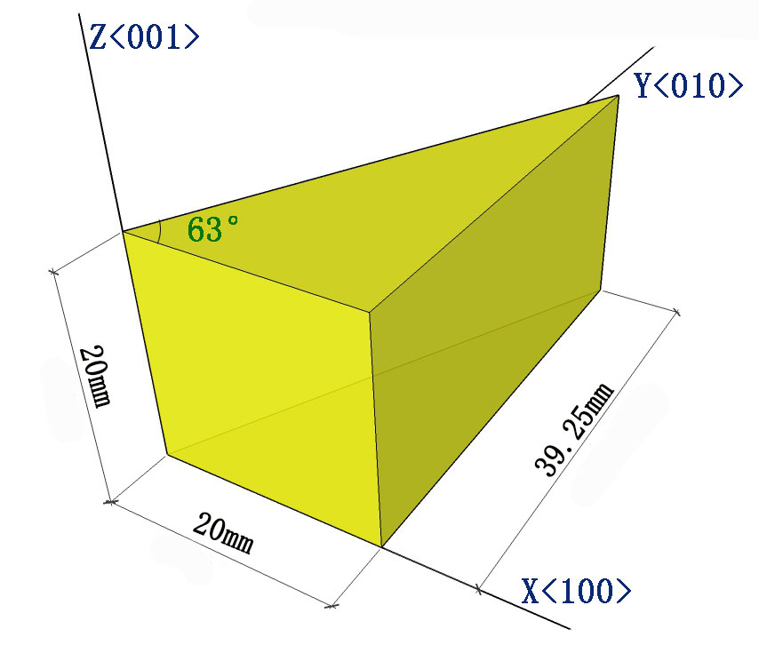

MgO- LiNbO3-20x39.25x20
· Size    20x39.25x20mm
· Wedge angle    63°

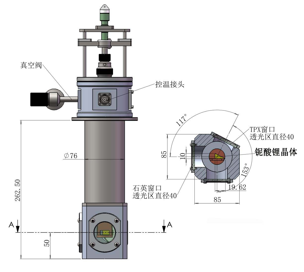

可选装置
上海屹持推出专门的液氮杜瓦低温装置,用于降低铌酸锂晶体的温度,从而提高太赫兹的转换效率
800nm入射窗石英窗片,有效孔径40mm
THz出射窗口TPX窗片,有效孔径40mm
最低控温温度80k
安装适配器杜瓦瓶下方可以定制适配器用于安装旋转台,多维位移台等
可根据用户需求提供定制的低温装置
