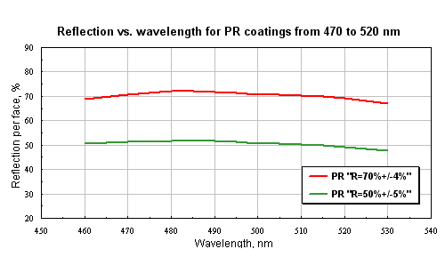

  • UV Fused Silica beamsplitter, R=50% +/-5%/ R=70% +/-4% @ 470-520 nm, laser parameters - 50 mW/cm2, CW @ 488 nm & 514.5 nm
Reflection vs. wavelength for PR coatings from 470 to 520 nm

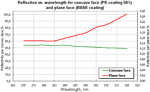

  • UV Fused Silica output laser cavity mirror for XeCl laser, AR (R <= 0.25%) @ 280-308 nm/R=50.0 +/-5% @ 280-308 nm, AOI=0°
Reflection vs. wavelength for concave face (PR coating-50%)  and plane face (BBAR coating)

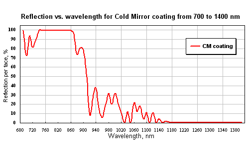

  • BK7 dichroic mirror (cold mirror), R >= 99.5% @ 800 +/-40 nm, T >= 85% @ 950-1400 nm, AOI=45°, laser parameters - 4 J/cm2, 8 ns, 20 Hz
Reflection vs. wavelength for Cold Mirror coating from 700 to 1400 nm

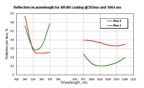

  • BK7 plano-convex lens, AR/AR (R <= 0.25%) @ 1064 nm & 355 nm, AOI=0°, laser parameters - 3 J/cm2, 6 ns, 20 Hz
Reflection vs. wavelength for AR/AR coating @355nm and 1064 nm
