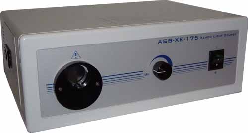

ASB-XE-175氙灯光纤光源
     ASB-XE-175是一种紧凑型,高强度光纤光源。特别适合作为光源用于分光光度计,显微镜,光学扫描,医学和工业使用,也可以用于SP的DK系列单色仪和光谱仪。
使用CERMAX® 的175W高功率,紧凑的灯泡,175w短弧氙灯输出光谱带宽从200-2200nm(最好区域在250-1100nm范围)。这种灯是紧凑的,耐用的,很方便把光聚焦到一根液态光纤中。灯的发光效率通过一个抛物面镜得到增强,进入精密的准直系统优秀的传输光能量。灯点燃之后马上光束就可以稳定下来,并且ASB-XE-175可以不用时间延迟就马上再点燃。
特点:
  • 高色温 (5600ºK)
  • CERMAX® 准直
  • 氙灯
  • 亮度功率可调 (0 - 100%)
  • 可拔插,轻便
应用:
  • 光谱学
  • 显微
  • 可视化检查
  • Boroscopes
  • 机器视觉
  • 光学扫描
  • 数据和视频设计
FeatureValue
Lamp:
Type: CERMAX® LX175F
Power: 200 Watts (maximum)
Power Range: 150-200 W
Color Temperature: 5600°K
Current: 14 amps DC (nominal)
Average Life: Typically 1000 hours (500 hours minimum)
Voltage: 12-17V (14V nominal)
Trigger Voltage: 25 Kilovolts
Boost Voltage: 140-200 Volts
Current Leakage: < 300mA
  • ASB-XE-175-EX: UV extended, 200nm ~ 2200nm (dominant, 250nm ~ 1100nm)
  • ASB-XE-175-BF: Ozone blocking, 320nm ~ 700nm
  • ASB-XE-175-BFEX: NIR extended, Ozone blocking, 320nm ~ 2200nm (dominant, 320nm ~ 1100nm)
Weight:7.5 lbs. (3.4 kg)
Input Line:95-136 VAC, 50/60 Hz (only)
Input Current:3.5 amp.
Environment:Operating: +6 to +45°C
Storage: -40 to +70°C
Front Panel:Brightness Control (0-100%)
Output Aperture
Side Panel:Main Power (On/Off)
Line Cord Jack (IEC 320)
(US to IEC Line Cord included)
Fuse Holder - MDL-5
Caution:Damage to glass or fused silica fiber optic lightguides can occur due to high temperatures associated with Xenon lamps. Use our liquid light guides (order separately).
