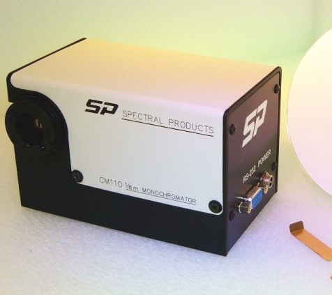

CM110 1/8m单色仪
型号: CM110
--- 产品详情 ---
CM110单色仪
          CM110是一款多功能、高性价比的紧凑型单色仪,产品尺寸:约13x8x8cm;采用高质量双光栅塔台、单独组件设计,通过RS232连接电脑,是一种完全计算机控制,双向光栅驱动的单色仪,其中消隙传动装置确保设备在一些严格的应用中保持稳定高效运行。CM110适用于荧光、辐射、过程控制、颜色、可调滤波器、拉曼光谱等测量领域。CM110理想工作范围在UV~IR。所有设备在出厂前均严格的定标,操作软件操作十分简单方便。
产品特点:
  • 紧凑的设计4.75"x2.75"x2.75"
  • RS232接口连接电脑
  • 允许大光谱范围的双光栅设计
  • 厂家预装成一套完整的单色仪和光谱仪
  • 扫描范围在纳米、埃、微米、波数或者eV
  • 改变狭缝方便
  • 单色仪厂家预装调整好光栅角度和矫正
应用:
  • 荧光
  • 辐射测量
  • 精密控制
  • 色度分析
  • 可调滤波
  • 拉曼光谱
  • 光谱分析
产品参数:
 Feature Value
 Design: Czerny-Turner, dual-grating turrets
 Focal Length: 110mm
 f/#: 3.9
 Beam Path: Straight through standard, right angle provided on request.
 Wavelength Drive: Worm and wheel with microprocessor control and anti-backlash gearing.
Bi-directional. Usable in positive or negative grating orders.
 Wavelength Precision: 0.2nm
 Wavelength Accuracy: ± 0.6nm
 Slewing Speed: >100nm/second
 Stray Light: <10-5
 Slits: Standard Set includes; 0.125mm, 0.15mm, 0.30mm,
0.6mm, 1.2mm and 2.4mm x 4.0mm. For other sizes, consult SP.
 Max Resolution: <1nm w/1200G/mm grating and standard slits
 Gratings: One to two gratings. (30 x 30mm) must be purchased.
See CM grating options page
 Software: Demonstration control program
and LabView driver included.
 Power: UL listed 110/220V power pack
 Interface:RS232 standard
 Warranty: One year
 Options:
  • Hand-held control module with function keys and display for local control
  • IEEE-488 interface
  • Interface cables
  • Gold optics
See options and accessories
