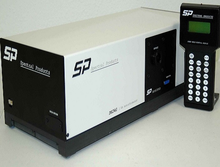

DK240 1/4m 单色仪
型号: DK240
--- 产品详情 ---
DK240是一个与电脑结合的优秀的解决方案。三光栅塔台容易控制,电动控制狭缝宽度,和可供选择的快速的电动滤光轮。仪器可被设置为恒定的分辨率,自动修改狭缝宽度,补偿变化中的色散与波长,保持恒定的光谱带宽。坚固耐用,A级散热设计,SP的光栅驱动器使得可重复性和可靠性好,出厂前校准。
产品特点:
  • 计算机接口RS232 or IEEE-488
  • 电控狭缝
  • 三光栅系统提供宽波长范围高效率扫描
  • 根据用户要求既可设计为单色仪也可作为摄谱仪
  • 可以正反方向扫描并保持恒定的光谱分辨率
  • 与SP滤光片轮构成自动滤光片开关
  • 适合于荧光光谱、吸收光谱、探测器特性、薄膜测量等方面研究
产品参数:
 Feature Value
 Design: Czerny-Turner, triple-grating turrets standard.
 Focal Length: 240mm
 f/#: 3.9
 Reciprocal Dispersion: 3.2nm/mm (with 1200 g/mm grating)
 Wavelength Drive: Worm and wheel with microprocessor control and anti-backlash gearing.
 Bi-directional. Usable in positive or negative grating orders.
 Wavelength Precision and reproducibility: 0.007nm (with 1200g/mm grating)
 Wavelength Accuracy: ± 0.30nm standard (with 1200 g/mm grating)
 Scan Speed: 1 to 1200nm/minute (with 1200g.mm grating)
 Stray Light: < 0.01% at 220nm (Nal)
 Slits: Unilateral, computer controlled, curved entrance and straight exit standard.
 Width - 10μm to 3000μm
 Height - 2mm to 20mm
 Max Resolution: 0.06nm (with 1200 g/mm grating)
 Gratings: One to three gratings (68 x 68mm standard, 68 x 84mm optional) must be purchased. See DK Gratings.
 Software: Demonstration control program and LabView driver included.
 Power: 100 - 240V, 50/60Hz, 60W
 220/230/240V, 50/60Hz @ 0.5A optional.
 Interface: RS232 standard
 Weight: 35lbs
 Warranty: One year
 Options:
  • DKBS - Bi-lateral slits
  • DKGPIB - IEEE-488 communication interface (internal)
  • DK2400 and Hand-held controllers for local control
  • IR240 - Gold optics
  • DK2PORT - Bifurcated fiber bundle for attaching 2 devices to 1 port.
  • AB300 - Automated 6 position filter wheel
See options and accessories
光栅选型表:
                                          DK Series Standard Gratings, 68 x 68 mm
Part #
Ruling
Peak
Range (nm)
Peak %T
(G/mm)
(nm)
AG2400-00240-6862400240180 - 68070
AG1200-00200-6861200200180 - 45065
AG1200-00250-6861200250180 - 46070
AG1200-00300-6861200300200 - 75072
AG1200-00500-6861200500330 - 100083
AG1200-00600-6861200600400 - 150080
AG1200-00750-6861200750480 - 150085
AG1200-01000-68612001000550-150075
AG0600-00500-686600500350 - 130080
AG0600-01250-6866001200800 - 300085
AG0600-01600-6866001600950 - 300093
AG0300-00500-686300500310 - 110080
AG0300-02000-68630020001200 - 400088
AG0300-02500-68630025001500 - 600088
AG0300-03000-68630030001800 - 600080
AG0150-00500-686150500320 - 98072
AG0150-04000-68615040002500 - 900093
AG0075-08000-6867580005000 - 1500082
AG0050-00600-68650600400 - 120078
AG0050-12000-68650120007500 - 2000082
NOTE: Ruled gratings blazed at other wavelengths and holographic gratings are available on request.
