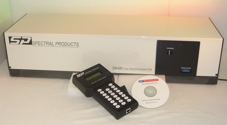

DK480 1/2m 单色仪
型号: DK480
--- 产品详情 ---
DK480是一个与电脑结合的完美解决方案。三光栅塔台容易控制,电动控制狭缝宽度,和可供选择的快速的电动滤光轮。仪器可被设置为恒定的分辨率,自动修改狭缝宽度,补偿变化中的色散与波长,保持恒定的光谱带宽。坚固耐用,A级散热设计,SP的光栅驱动器使得可重复性和可靠性好,出厂前校准。
产品特点:
  • 通过RS232 或者 IEEE-488连接任何电脑.
  • 电动控制狭缝宽度.
  • 三光栅塔台能对大范围波长进行扫描,分光.
  • 厂家预装配单色仪和光谱仪.
  • 直接扫描和连续光谱分辨 (CSR).
  • 预配置SP滤波轮和开关.
应用范围:
  • 荧光光谱
  • 吸收光谱
  • 探测器特性
  • 薄膜测量等
产品参数:
 Feature Value
 Design: Czerny-Turner, triple-grating turrets standard.
 Focal Length: 480mm
 f/#: 7.8
 Reciprocal Dispersion: 1.60nm/mm (with 1200 g/mm grating)
 Wavelength Drive: Worm and wheel with microprocessor control and anti-backlash gearing.
 Bi-directional. Usable in positive or negative grating orders.
 Wavelength Precision and reproducibility: 0.007nm (with 1200g/mm grating)
 Wavelength Accuracy: ± 0.30nm standard (with 1200 g/mm grating)
 Scan Speed: 1 to 1200nm/minute (with 1200g.mm grating)
 Stray Light: < 0.01% at 220nm (Nal)
 Slits: Unilateral, computer controlled, curved entrance and straight exit standard.
 Width - 10μm to 3000μm
 Height - 2mm to 20mm
 Max Resolution: 0.03nm (with 1200 g/mm grating)
 Gratings: One to three gratings (68 x 68mm standard, 68 x 84mm optional) must be purchased. See DK Gratings.
 Software: Demonstration control program and LabView driver included.
 Power: 100 - 240V, 50/60Hz, 60W
 220/230/240V, 50/60Hz @ 0.5A optional.
 Interface: RS232 standard
 Weight: 45lbs
 Warranty: One year
 Options:
  • DKBS - Bi-lateral slits
  • DKGPIB - IEEE-488 communication interface (internal)
  • DK2400 and Hand-held controllers for local control
  • IR480 - Gold optics
  • DK2PORT - Bifurcated fiber bundle for attaching 2 devices to 1 port.
  • AB300 - Automated 6 position filter wheel
See options and accessories
