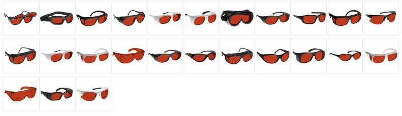

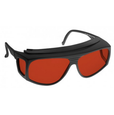

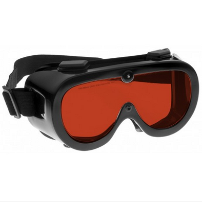

激光防护镜
激光防护镜就是能够防止或者减少激光对人眼伤害的一种特殊眼镜。激光防护镜是一种高效安全的护目镜,适用于多种激光器,激光笔,这一系列光安全眼镜配戴舒适、美观、安全可靠。其光学安全性能完全满足GJB1762-93,激光安全眼镜有反射式有吸收式的,可全方位防护特定波段的激光和强光.适用于多种激光器设备.可见光透过率达到70%以上.光密度为5.0以上,(OD+5,OD+6)
各种外观可选
型号
防护参数OD系数
YG3
190-400 OD 5+, 808-840 OD 4+, >840-950 OD 5+, >950-1080 OD 7+, >1080-1090 OD 5+
ARG
180-532 OD 7+
DI8
190-400 OD 5+,800-830 OD 5+,805-825 OD 7+
HOY
190–400 OD 5+,1450–1650 OD 2+,>1650–1775 OD 3+,>1775–3000 OD 4+
1980–2550 + 5200–11000 OD 5+,9000–10600 OD 6+
DBY
190-534 OD 7+,850-925 OD 5+,925-1070 OD 6+,960-1064 OD 7+
TRI
180-534 OD 7+,720-770 OD 5+,750-760 OD 7+,770-850 OD 4+
850-1080 OD 5+,980-1064 OD 7+
YG2
180-400 OD 6+,720-1090 OD 5+,750-1064 OD 7+
YG5
190-400 OD 5+,1025-1075 OD 5+,1035-1070 OD 6+,1045-1065 OD 7+
AG3
190-400 OD 5+,518-523 + 533-536 OD 2+,524-532 OD 3+
EC2
190-398 OD 7+,9000-11000 OD 7+
YAD
180-534 OD 7+,720-730 OD 5+,>730-740 OD 6+,>740-1070 OD 7+
IRD
190-450 OD 6+,770-1800 OD 2+,820-1720 OD 3+,870-1600 OD 4+,940-1070 OD 5+
CO2
190-360 OD 5+,10600 OD 5+
RBG
190-410 OD 5+,>410-488 OD 2.5+,>488-532 OD 1+,555-568 OD 1.5+
561 OD 2.5+,632-660 OD 1.5+,640-650 OD 2.9+
YG4
190-400 OD 6+,750-1120 OD 6+,800-1100 OD 7+
AXX
190-400 OD 6+,720-810 OD 7+ ,>810-830 OD 5+
YAD
DBD
190-534 OD 7+,760-1090 OD 5+,790-850 OD 7+,>850-960 OD 6+,>960-1070 OD 7+
DLS
180-400 OD 6+,785-830 OD 7+
