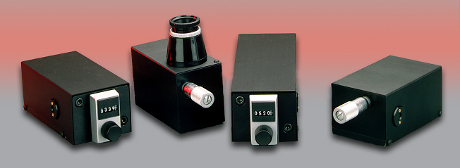

Mini-ChromTMUV-VIS-IR单色仪
l 小尺寸
l 性能优越
l 适合于OEM客户和研究应用
l 48个标准型号
 可定制
l 市场已售2万台(原厂数据)!

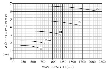

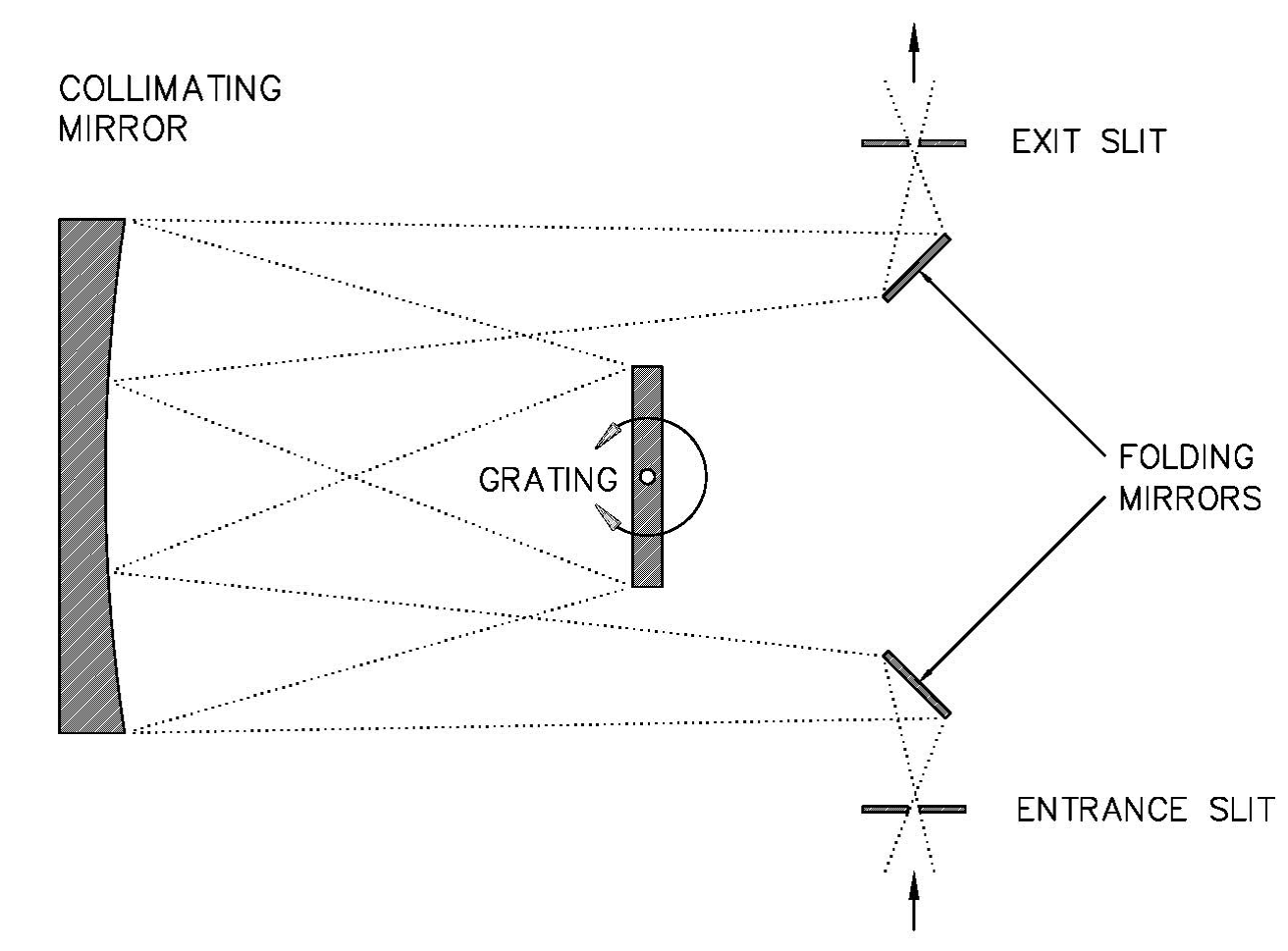

 单色仪内部光路结构                             300μm狭缝时分辨率

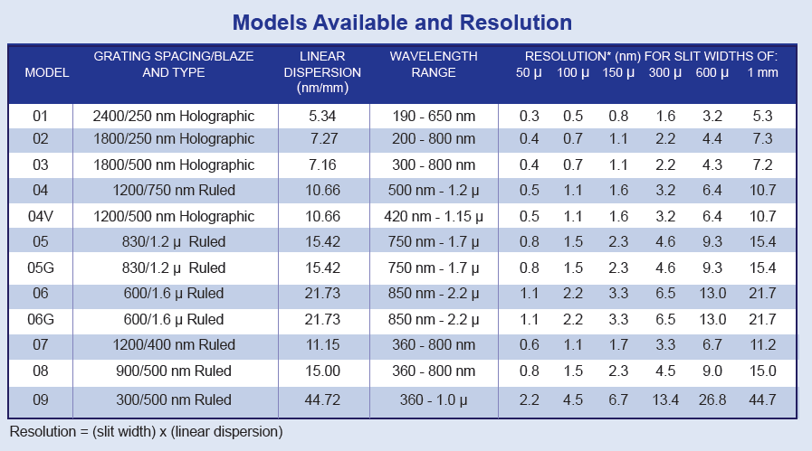

             各系列分辨率对照表(如手动MC1-01对照上表01
手动式MC系列选型表:                      软件控制式DMC系列选型表:
代码
产品型号
波长范围
代码
产品型号
波长范围
6-0101
MC1-01
190 - 650 nm
6-0401
DMC1-01
190 - 650 nm
6-0102
MC1-02
200 - 800 nm
6-0402
DMC1-02
200 - 800 nm
6-0103
MC1-03
300 - 800 nm
6-0403
DMC1-03
300 - 800 nm
6-0104
MC1-04
500 nm - 1.2 μ
6-0404
DMC1-04
500 nm - 1.2 μ
6-0105
MC1-04V
420 nm -1.15 m
6-0405
DMC1-04V
420 nm -1.15 m
6-0106
MC1-05
750 nm - 1.7 μ
6-0406
DMC1-05
750 nm - 1.7 μ
6-0107
MC1-05G
750 nm - 1.7 μ
6-0407
DMC1-05G
750 nm - 1.7 μ
6-0108
MC1-06
850 nm - 2.2 μ
6-0408
DMC1-06
850 nm - 2.2 μ
6-0109
MC1-06G
850 nm - 2.2 μ
6-0409
DMC1-06G
850 nm - 2.2 μ
6-0110
MC1-07
360 - 800 nm
6-0410
DMC1-07
360 - 800 nm
6-0111
MC1-08
360 - 800 nm
6-0411
DMC1-08
360 - 800 nm
6-0112
MC1-09
360 nm - 1.0 μ
6-0412
DMC1-09
360 nm - 1.0 μ
描式SDMC系列选型表:                      扫描式SMC系列选型表:
代码
产品型号
波长范围
代码
产品型号
波长范围
6-0501
SDMC1-01
190 - 650 nm
6-0201
SMC1-01
190 - 650 nm
6-0502
SDMC1-02
200 - 800 nm
6-0202
SMC1-02
200 - 800 nm
6-0503
SDMC1-03
300 - 800 nm
6-0203
SMC1-03
300 - 800 nm
6-0504
SDMC1-04
500 nm - 1.2 μ
6-0204
SMC1-04
500 nm - 1.2 μ
6-0505
SDMC1-04V
420 nm - 1.15 m
6-0205
SMC1-04V
420 nm - 1.15 m
6-0506
SDMC1-05
750 nm - 1.7 μ
6-0206
SMC1-05
750 nm - 1.7 μ
6-0507
SDMC1-05G
750 nm - 1.7 μ
6-0207
SMC1-05G
750 nm - 1.7 μ
6-0508
SDMC1-06
850 nm - 2.2 μ
6-0208
SMC1-06
850 nm - 2.2 μ
6-0509
SDMC1-06G
850 nm - 2.2 μ
6-0209
SMC1-06G
850 nm - 2.2 μ
6-0510
SDMC1-07
360 - 800 nm
6-0210
SMC1-07
360 - 800 nm
6-0511
SDMC1-08
360 - 800 nm
6-0211
SMC1-08
360 - 800 nm
6-0512
SDMC1-09
360 nm - 1.0 μ
6-0212
SMC1-09
360 nm - 1.0 μ
