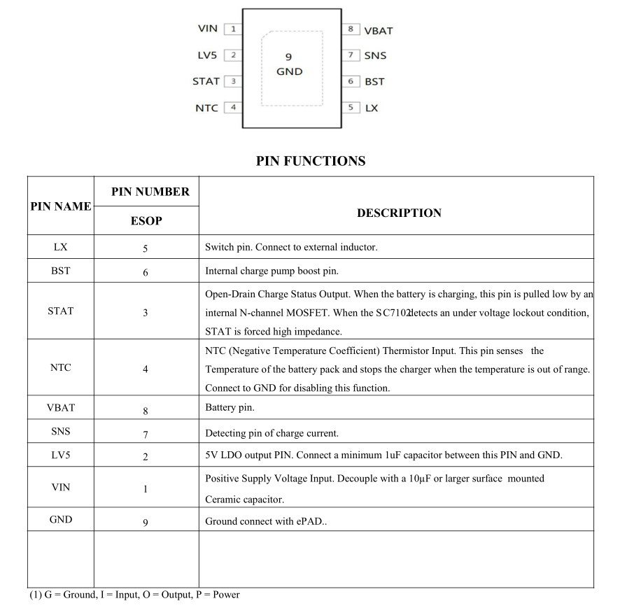

--- 产品参数 ---
- 输入耐压 9-20V
- 充电电流 3A
- 封装 SOP8
- 最小包装 3000

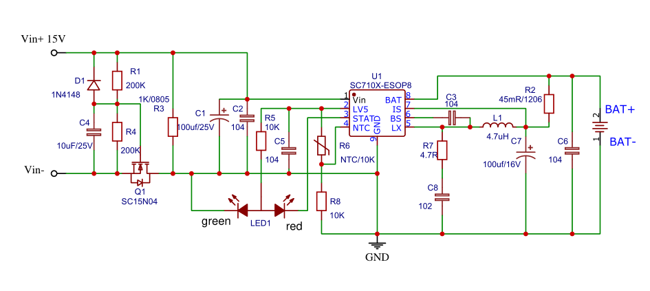

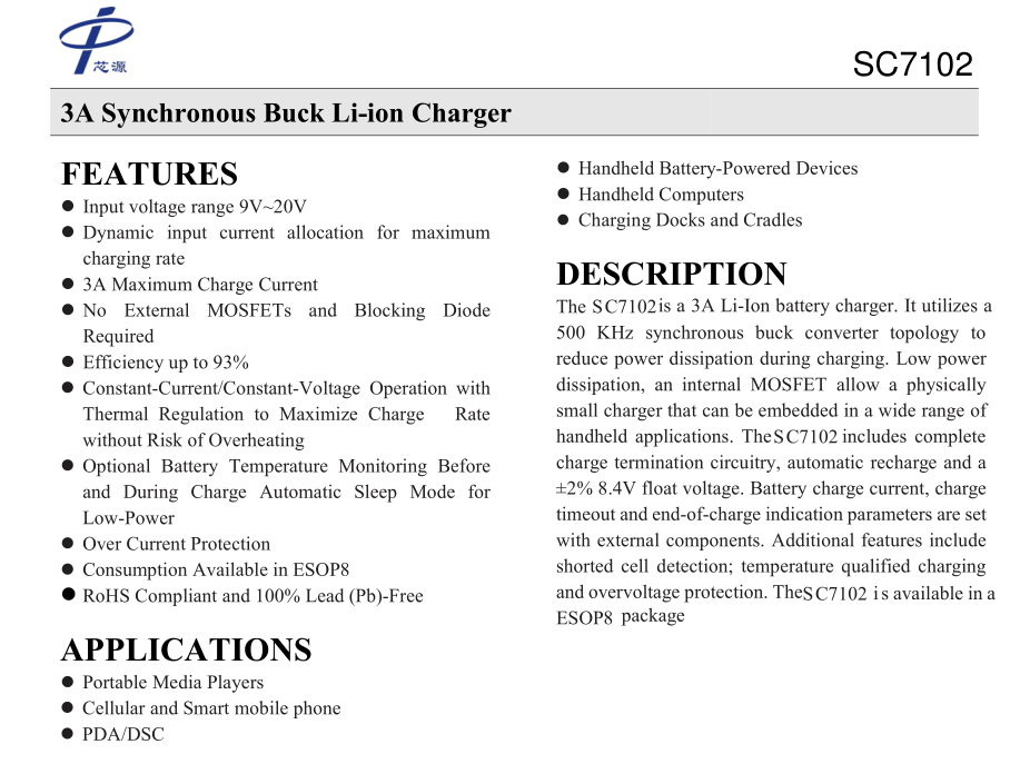

FEATURES
Input voltage range 9V~20V
Dynamic input current allocation for maximum
charging rate
3A Maximum Charge Current
No External MOSFETs and Blocking Diode
Required
Efficiency up to 93%
Constant-Current/Constant-Voltage Operation with
Thermal Regulation to Maximize Charge Rate
without Risk of Overheating
Optional Battery Temperature Monitoring Before
and During Charge Automatic Sleep Mode for
Low-Power
Over Current Protection
Consumption Available in ESOP8
RoHS Compliant and 100% Lead (Pb)-Free
APPLICATIONS
Portable Media Players
Cellular and Smart mobile phone
PDA/DSC
Handheld Battery-Powered Devices
Handheld Computers
Charging Docks and Cradles
DESCRIPTION
The SC71 is 3A Li-Ion battery charger. It utilizes a
500 KHz synchronous buck converter topology to
reduce power dissipation during charging. Low power
dissipation, an internal MOSFET allow a physically
small charger that can be embedded in a wide range of
handheld applications. The includes complete
charge termination circuitry, automatic recharge and a
±2% 8.4V float voltage. Battery charge current, charge
timeout and end-of-charge indication parameters are set
with external components. Additional features include
shorted cell detection; temperature qualified charging
and overvoltage protection. The is available in a
ESOP8 package
